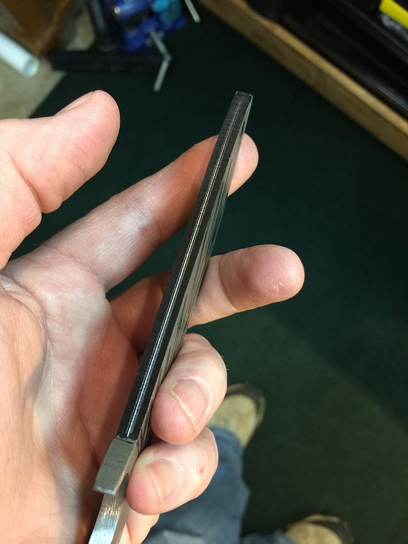

    centerline scribed. Waiting on PPE and then the sparks are gonna fly!:p

  4. MTFatboy
    MTFatboy Loaded Pockets
    Mar 30, 2014
    2,001
    18,309
    Is there a handy trick to this?
  5. survivorman
    survivorman Loaded Pockets
    Jan 21, 2009
    1,110
    33,923
    I guess this maybe could be done with a precise little combination square and a scriber.
  6. de Vries
    de Vries EDC Junkie!!!
    Apr 5, 2014
    1,421
    31,932
    Or a drill bit less than half the thickness of the blade. You use a flat surface and the drill to draw the lines.
  7. SMAJ
    SMAJ Loaded Pockets
    Apr 21, 2014
    2,528
    23,279
    survivorman, de Vries that is what I did...drill bit. I have watched more YouTube than I can recall to answer all of my questions regarding knife making! Once of the vids said use a drill bit that is the exact width of your blade to find the center line, then I went to the next one down so that I will grind just to where there will be about a dime width left..read that you want to do that for heat treat to help prevent warping.
